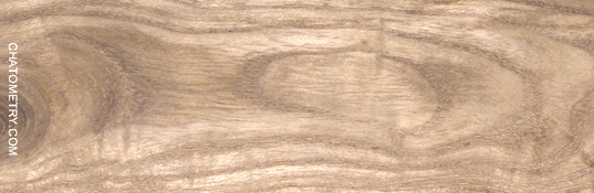

I found a small branch (3") of this stuff:
Quite dark just after slicing...
then it dried to a lighter brown.
The endgrain seems to perfectly match black locust, but the colour doesn't: it is brownish, with no yellow at all.

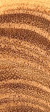

This is a ¼" endgrain detail:
and before you ask: no reaction to blacklight:
Could it be another Japanese Scholar Tree?
This below is from another recent thread where Japanese Scholar Tree was suggested:
Thanks!!!

I got some better pictures after polishing and vacuum cleaning.
Overall view:
¼" areas:
Do the yellowish things in the pores represent tyloses?

I tried to fume my sample with ammonia, but there is no reaction. This confirms it is most likely NOT black locust.
Laburnum seems to me the most likely option, but I don't know if we should rule it out due to tyloses.

No, the yellow seen are likely gums and resins or even super fine sawdust that did not come out. The tyloses look like silicates, tiny pieces of glass or even sugar. These are often hidden by sanding end grain even with vacuuming. A quick and easy is to use a razor blade and slice off a few shavings to see clean fresh wood. Be safe.
