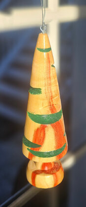

Late, just forgot about the deadline. I'm pretty sure I saw this idea somewhere on this forum, but don't remember for sure or who posted. At any rate, my bride wanted a turned ornament and this had been in the back of my mind since seeing it so thought I'd kill 2 birds with 1 stone. Some of Kevin's FBE, stabilized so hopefully the color will hold long term. Spray-on lacquer finish.
