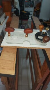

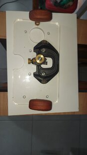

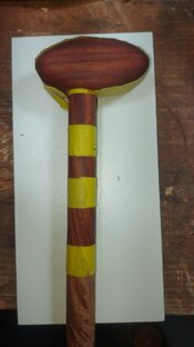

At this time I made a pair of knobs for my router plane acrylic base .
I was using same knobs for both bases and now I have an extra pair.

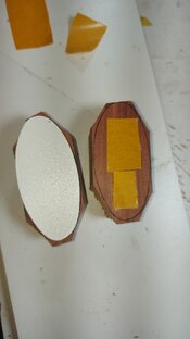

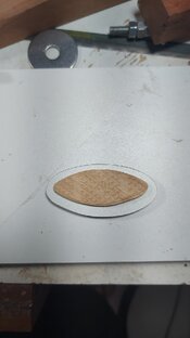

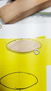

The shape I copied from a #20 biscuit and transfered to a MDF template.
They are very comfortable at hands .
See the pictures below:
The biscuit was sanded because rough edge
MDF template
Ready to sand

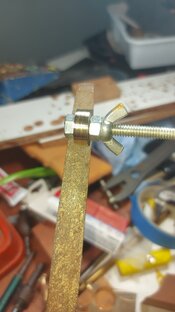

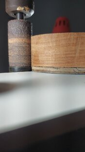

Template sander
3/8 " roundover bit at edges

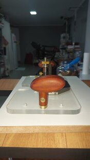

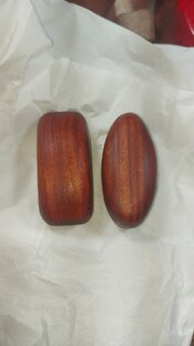

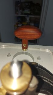

The round part has a tapped hole.The washer works as a spacer because I cutted short at first.
The shape

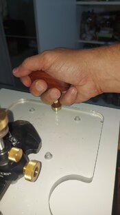

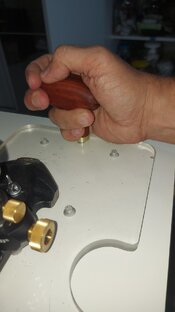

Very comfortable

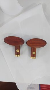

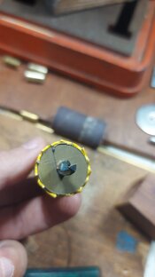

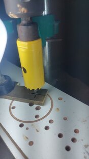

During the process I cutted the "neck" shorter...it is a bad feeling when we do this having a lot of wood yet.
So using a brass plate and a holesaw (24 mm outside diameter means 20 mm inside.)
The diameter of wood is 3/4" so I glued using epoxy and sanded to fit perfect match brass/wood
The mistake added charm at final.
Wood enough
That holesaw from kit never used before
The inside diameter is what you need
File a little and sand perfect after glued
Other position for hand
The 5 mm screw locked at round tapped bar
