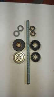

I found cheap bearings near home...I used a M8 threaded bar...nuts and did it.
See the pictures below:

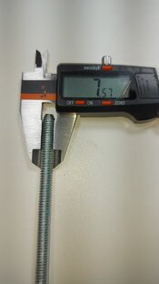

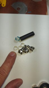

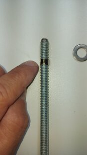

A M8 is not a real 8mm diameter but bearing inside is a true 8mm.I used a cable conector lock to add extra "wall" for threaded bar.
This piece saved the job

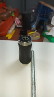

All we need

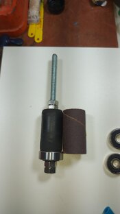

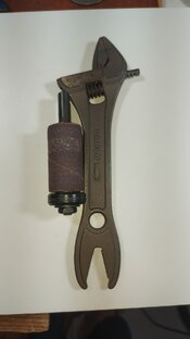

Works great
Lee Valley model

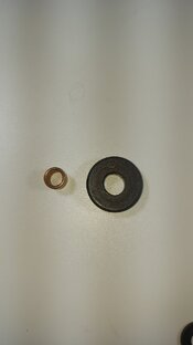

Simple bronze and plastic (special)
Because is normal thread (not left) we need two nuts for lock and dosen't loose when runing.

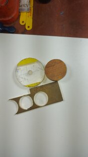

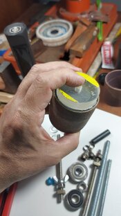

You can do yourself bearing for small or only one project.Just for picture this acrylic is smaller ...just for example
From brass ...wood...acrylic ...or any similar hard material
The wall I needed
