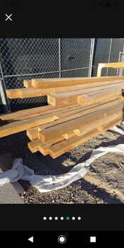

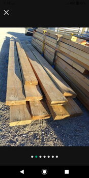

vegas urban lumber
3,990
6,342
las vegas
trev
i recently bought 1 1/2 semi trailer loads of cull fir lumber and beams from local lumber distributor. bulk of it is in 4"x6" x 16' long and bigger.
i ordered 6" and 8" timber screws, and intend to build a number of various heavy thickness bench tops. i'm thinking 4" thick 30" wide and 7 ft long for starters
