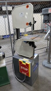

anyone near reno nevada, nice bandsaw on auction
That's the biggest stop button I've ever seen. Sure does make it very easy to hit the stop button with a knee after cutting your hand.

probably big so you can keep your hands on piece, hit it with knee. all 3 of my saws have foot brake. which shuts off saw. almost never do I use off button.
