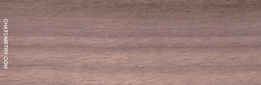

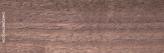

Bad news after sanding a black walnut sample up to 10'000-grit.
That is, chatoyance keeps growing as grit increases, and even at 10'000-grit it looks like it's still growing!
In addition, chatoyance after finishing with shellac is significantly higher on this ultra-fine-sanded sample than on its bookmatched twin, which was sanded to 240-grit.
Sample 1 after sanding to 240-grit:
Sample 1 after sanding to 10'000-grit:
More info here, after the Iroko section:

That's the point! Ultra-fine sanding + shellac gives more chatoyance than normal sanding + shellac!
That is, at least on these black walnut samples.

After these results, we repeated the same test on 4 more species (iroko, sapele, black locust and spanish cedar). In all the cases, sanding to 10'000 provided much higher chatoyance also after finishing!
More data here:
