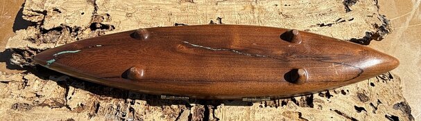

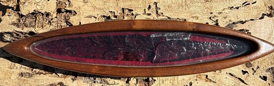

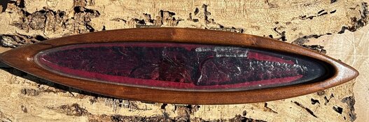

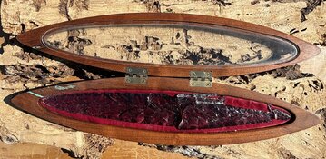

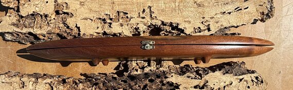

IMG_5894.jpeg HeThe above picture shows the breaks. Disappointed that my little buddy broke it, but really surprised the glass didn’t break. IMG_5895.jpeg I turned the case from a piece of Mesquite. I don’t remember what the OD is, but at the beginning of the turning, I cut a couple of square blocks to mount on each end. Located the centers, mounted and then turned it to the general shape you see. The blocks were the same size as the middle and were set correctly to separate extra material from the lid. After I established that, I then cut the lid from the body. I then cut the extra material from the body, leaving enough material to establish the feet using my dado set. It was pretty easy, l was pretty nervous. After the feet were dadoed, I used files to dress them up. IMG_5897.jpeg IMG_5898.jpeg Now I had to set up my pin router to make the glass opening. IMG_5896.jpeg
