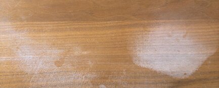

Used iron over double folded napkin to try and raise dents and damaged finish. Best way to repair? Wife not happy.
Issue getting better with time.

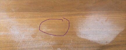

I know about dent repair. Picture of dent and screw up. Without, we do not have enough info.
@Mike Hill has restored furniture, he might be able to give more hints on restoration.
Or in obscure place see what melts it?
Is it veneer top?
Looks like water damage. Can't really see size and depth of dents. Soft edge dent it will work, sharp edge dent. No.
Again is it veneer ? How old? Then I will guess finish.
I suspect that could be a shellac finish. I would test it in a non-visible spot by rubbing with a white paper towel with a spot of denatured alcohol (which is the solvent for shellac flakes)
When you know what the finish is, it will be easier to plan how to fix it.
That's why I don't try dent repair unless,the piece is unfinished and even then I don't usually. If a compressed wood dent, the steam and heat could raise a bump that you then need to sand down. If it is an old piece it could be shellac. If not then likely a varnish of some kind or lacquer. Test in an inconspicuous place as @duncuss said with some denatured alcohol or even Everclear. Once you establish what finish it is, you can choose what watermark repair process. Sometimes you just have to get the stripper and sander out and refinish
Did you wipe it with rubbing alcohol? It works as a cleaner too. If it is a finish that has a few years on it, a simple quick wipe should not damage the finish at all. If it looks unchanged, try some of the above. If it looks better, then move to the next step.
The bloom ended up disappearing, dents still there, and I’ll leave well enough alone.
