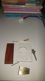

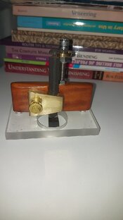

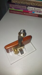

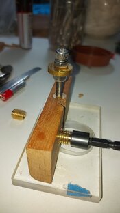

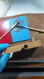

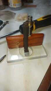

Hello Folks...at this time I would like to share my new project.
It is a small router plane made with Brazilian hardwood ,acrylic and brass.The blades are from my Lee Valley big Router Plane

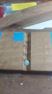

I insert a strong magnet to keep the blade in place even with loose lock.

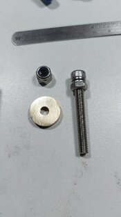

A washer can make the blade go up and down just turning a screw.It works pretty well.
The wood is:Peroba Mica (Aspidosperma Populifolium)
