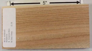

Chestnut and elm both have some chatoyance - see
On elm I never saw, however, such a bright surface like in your first picture.
Anyway, it's a wonderful piece; I suggest you to sand it up to #2500 to make the most of that figure!!!
To be clear, I wasn't saying Chestnut has no chatoyance. I was just saying that it doesn't have as much as Ryan's piece, and I was also saying that the chatoyance seems to vary within my own Chestnut supply. Ryan's piece reminded me of Birch due to the level of chatoyance, but its clearly not Birch. I think Red Elm looks right, but I do have some Catalpa somewhere that I could compare to as well.

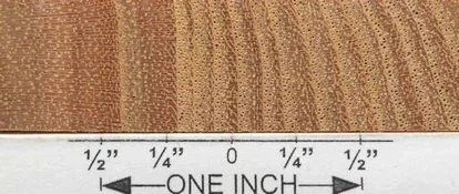

Here is a photo of Red elm, Ulmus rubra, from Keim wood supply. The issue I have is the ulmiform pore structure is almost always seen in any cathedral grain layouts. See the wavy pattern below? You can see it below Big Ry's thumb as well. However, this pattern is not always the case as seen with several samples on the hobbithouse site.
From the sawyer's point of view, they were thinking 'honey locust'. Slippery elm gets platy bark when it reaches larger diameters (16"+). The color of the bark can also be similar between Honey locust and Slippery elm. Both can have a 'piss-like" smell when milling. Next I think of location. Where was the tree harvested? When looking over USDA FIA tree density maps, Slippery elm is far less common in the eastern portion of PA. It is planted as a street tree sometimes, but quite rare in the wilds until you get closer to central PA.

I had somewhat gathered that scenario based on other items you said. That was why I mentioned the commonality of "Red elm" in the area. It is also why I was wondering about Scholar tree, being it also has compound leaves, can grow to a similar size and has bark lenticels that look similar to honey locust at certain growth stages.
I had pulled my samples of Scholartree, Styphnolobium japonicum, to look at end grain patterns, and mine lack any strong patterns of pore confluence. So, think that out as well. Seasoned Scholartree wood has a sweet and spicy smell when being worked.
