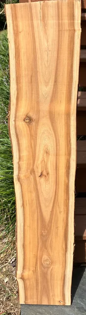

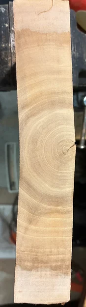

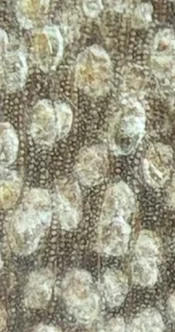

Hey guys, would you like your help on this one!
Got it from a Sawmill in Virginia many years ago. Was labeled persimmon, but obviously it’s not.
  • Density: 24.2 Ib/ft = approximately 387 kg/m = 0.387 g/cm.
  • MC: 7% to 9% from various readings.
  • Bark has been scraped off, except for maybe one or two tiny pieces in the photos.
  • Ever so slight putrid smell when cutting. Very, very light smell though, not strong at all.
  • About 1 inch of sap wood

Could it be black willow? My untrained can't tell the difference in the end-grain between my sample, black willow, eastern cottonwood or quaking aspen.

I am not an expert. My opinion....well, you have done a lot of work, however it would have been nice to see the face cleaned up too. Seeing the knots cleaned up can help. Willows usually have smaller pith hearts than the Aspen group. Your inner bark matches well to several willows and several Aspen. Being in the same family makes sense. Likewise for wood color and wood smell.
Your tree was only about 10 DBH when harvested and milled. Was it from a pallet mill? Otherwise that is small. At 10" DBH, Big-tooth and Quaking aspen are just starting to form coloration to heartwood. Likewise to be said about Eastern Cottonwood, White poplar and Black poplar. Balsam poplar often has heartwood at 10"DBH, but is it even in your area?
The tree willows also start forming coloration to heartwood at about 10" DBH, however, Black willow often does at 6" DBH.
You have 8" diameter and about 16 years growth, averaging 1/4" per year. The first 5 years average way more growth. This proportion is more often seen in 'pople' than in willows for your area. Based on what I see so far, I am leaning toward 'Lombardy' poplar, the male form. It starts with rapid growth and has heart color by 4 to 5 inches diameter. It often sucombs to sickness between 8-12"DBH. It has the stringy inner bark and often has a unpleasent smell.
These are just conclusions from general information and knowledge. I have yet to look at your end grain pictures.

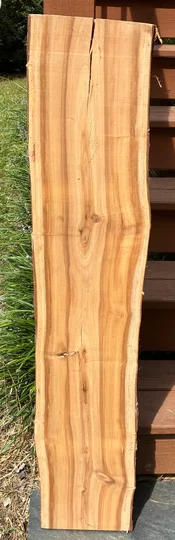

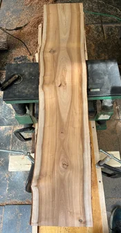

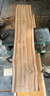

I planned the board today. First two pics are in the sunshine, second two are in the shade. Knot pics taken inside workshop.
IMG_0528.webp IMG_0529.webp IMG_0531.webp IMG_0530.webp IMG_0534.webp IMG_0532.webp IMG_0533.webp
Hi @Mr. Peet one other thing to add is that I didn’t smell any smell when planing it. Would you be willing to take one final look for me and offer any closing thoughts? I can take more photos (end-grain, knots, as needed). Thanks for all your help on this one!

Still not sure but I do like the choices of Populus and Salix. The Populus group often has a soft star shaped pith and I see picture 4 in post #2 looking to match well. However I failed to see that in the other knots posted. However, many of them I could not enlarge to get a closer look at pith. Still leaning toward Lombardy poplar based on color, size and weight.
