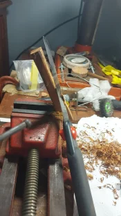

Shaping The Handles
Asssiss
456
1,407
Brazil
Emerson

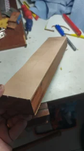

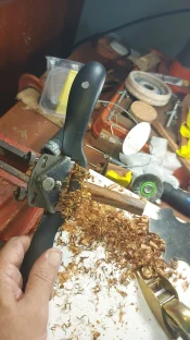

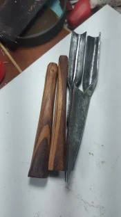

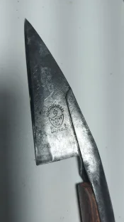

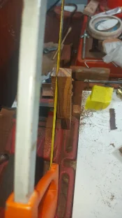

Hello folks...I am doing a pair of handles for my very small pair of sheep shears knife.
They are Burgon Ball British brand made in Sheffield.
I choose Gonçalo Alves as the wood handle.
I"ll add more pictures from each step progress.
See the pictures below:
The blue one at right
Burgon Ball

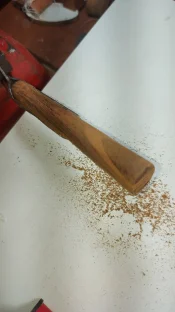

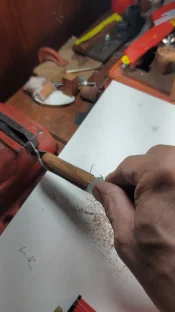

Cutting Gonçalo Alves
Shaping by hands
Spokeshave in action
Preparing for epoxy glue
All ready
The blade is very good for the age
Thanks for attention

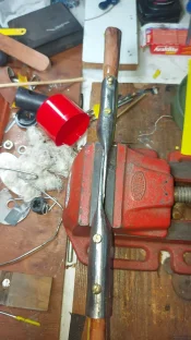

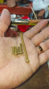

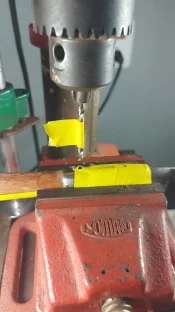

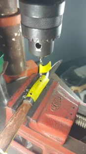

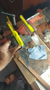

Hello folks...I glued the wood handles yesterday and today I glued the brass pins...in fact they are bolts 4mm .I purchased long ones and use they in sections until all used.Tomorrow I'll still shaping the handles for final shape and sand all blade and body...after that start at sharp the blade step.
Gluing handles
Drill step
Brass bolts 4mm
Gluing pins (bolts)
After dried file the heads off.

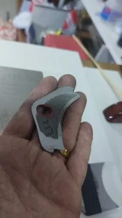

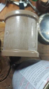

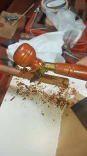

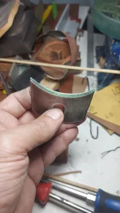

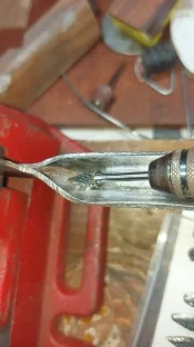

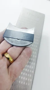

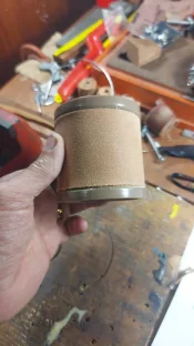

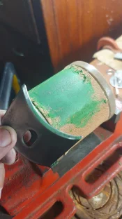

Hello folks...I just started to work at this project again.
I need to shape the handle for start to finish the edge of blade and sharpening after.
I never used a concave spokeshave before...I have one from Kunz for a long time but always at tool box.
Yesterday I started to sharpening the blade and it was very bad about back flatness.

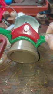

The cap was bad too.But to me the worst part was how to sharp the round blade.

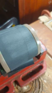

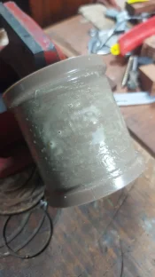

I choose a simple and nice way to do it.I glued a piece of leather at a PVC 60 mm coupling and used a fine water sandpaper (just a finger water applied) for sharp (400,600 and 1200 grit)...after a honing compound at leather strop.
It worked very well.
*If I work a lot with a concave spokeshave maybe a metal pipe can be better but for my use the PVC will last almost lifetime*
Checking the radius size
Contact cement
Like this
Sanded a little
Good grip
Green compound
Works very well
This is sandpaper and you cnan see the metal dust
Fits very well

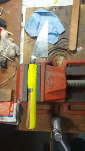

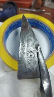

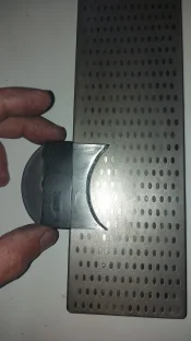

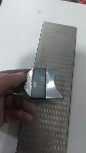

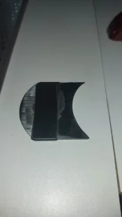

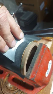

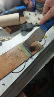

Hello folks...some more pictures...
The cap back after stone
I add an eletric insulation tape as a fence
Look how bad the back was
The tape fence limit how far you can go

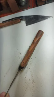

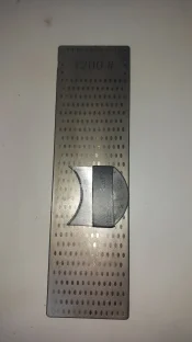

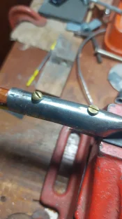

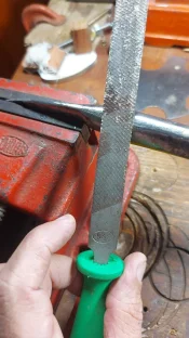

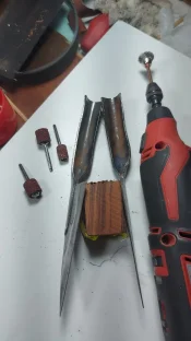

Hello folks...today I did one more step...

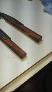

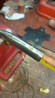

I filed the brass screw heads and started to sand the handles...
Gonçalo Alves is so nice to work with.
Time file the brass pins
Done
Medium file
Sanding the wood
So nice wood
After sanded 'll cut for final size

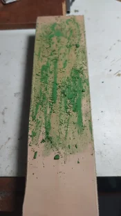

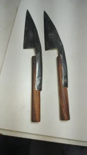

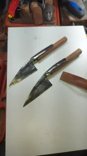

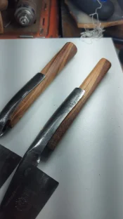

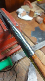

Hello folks...the nice thing to be an amateur woodworker is you can do things in your time...no timeline... not necessary to hurry up.
Today I finished my pair of small sheep shears knives.Three months after started.

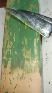

Just wax at handles...the blade is so sharp.
Short Video at YT:

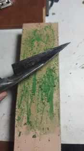

Green compound
Brand new leather strop
So sharp now
Just wax at handles (for while)
Gonçalo Alves wood
I let some scars at blade...they are original corrosion process and I need some of history and not a brand new knife
Very nice. I use diamond stropping compound because it doesn't break down and it has much less variation in grain size. While your chromium oxide likely says it has between 1 and 4 microns grain size it will have grain between 30 and 0.3 microns. I switched to diamond stuff mainly out of interest but have found it to yield slightly better results.
BUT would the shears still feel authentic after using diamonds on them? Not really.
Anyway most impressive work.
I do have diamond compound but they are more expensive and I keep they just for m hi-end plane blades and spokeshaves as well.
That knives someone can use too and make dull for bad use...so green compound will be enough for while and did a great job.
