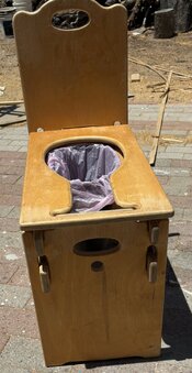

This is a jig I made to be used on my Pin Router. The jig is for a step stool I made later on, but is on the same lines as the original jigs, just different shapes on the chair and desk. On this jig here, it can be used for an end from 12" high to 30". I would cut my piece needed size, lock it into place with the De Sta Co's(clamp with the red handle), and then rout the holes and then the top shape.
This shows a 12" end with the approximate location on the jig. I normally used a piece of Baltic scrap at the bottom for the different sizes I was making. The detail at the bottom was done on my jointer to have the item to sit flatter on an uneven surface.
This picture shows a side I made for a portable camping toilet. The TP holder hole is the indicator. It was made within the last 10 years and is the prototype for the others I never made. That slot is for a bottom I added to the stool to turn it into a storage box.
This is the fit. I believe the top is at 16 or 17" from the floor but I've made them from 6" up to the 17" height. Later today if anyone is interested, I'll post pictures of the finished toilet. It's impressive. :lol2:
This was put together in haste. Anything that is confusing, please do not hesitate to question me. ........... Nubs.

Think you should post pics of the finished toilet.

You want to see it empty or full. :sofa:
This toilet in nothing more than a design that uses the design from all the others things I've made using the Hook and Slot method of assembly. When mnot in use, it can be disassembled, stacked and storred somewhere that you store stuff not used a lot.
Here it is. There are a couple made since the side piece I showed in the above post. Nutting major. One was the trash can I was using got broken during one of my camping trip. so got another and it was smaller. I added a piece on each side supports to hold the can in place. Also changed the location of the TP holder.
