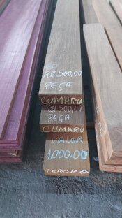

Hello folks...last Friday I visited one wpod store at my state and found there for sell a piece of Cumarú (brown color) like someone comented here.
First time I saw brown Cumaru instead yellow.
The board price is R$ 500 (around US$ 93 ) size:
1700x250x70 mm
Thanks for attention
