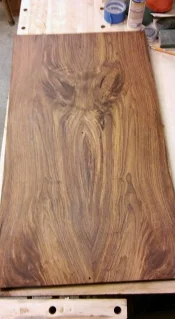

I rejointed the edges, each side bowed 1/16". I'm pretty sure I went from slab to glued up panel too quickly.
Should have cut the boards and let sit a month.
After jointing, I gave each piece a few swipes with 80 grit, then wiped with naphtha, wet one side, then glued with gorilla glue

This joint was prepped well, and fit tight. Then the wood shifted and bowed. Had I used butterflies, the boards would have cracked in a different spot
What kind of wood is it? looks like walnut in some of the pics. Guess it had some more moving to do. I made quite a bit of furniture when I live in San Diego and it held up great for years (humid coastal climate) as soon as I move to AZ I had those kinds of issues with several pieces. Moving geographical locations with solid wood is a bitch....
IIRC it was a rosewood...
