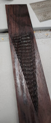

First pass in initial directions. Outer "master" lines weren't perfect, but enough to get me started this time. I need to work on getting then straighter.

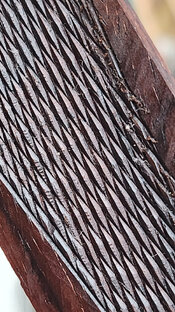

As I somewhat expected, things got tougher when I switched directions... maybe my initial lines were a little too deep. And the acuteness of the angle probably wasn't ideal for a first time. I lost my place a few times, but got a section I wasn't too unhappy with in the central area. Then took a couple passes with a 75° and one with 90° before brushing it off and a quick wipe with some oil to get a better look.
The closeup shows I need to go deeper with the 90 and also that I was getting some vibration/chatter due to not having it stable. I'll wipe my next practice piece and let it dry before starting on it so I'll have better visibility of the diamonds and maybe set up a less acute triangle. That said not too awful for a first run.
I don't know enough, yet, to have good questions - but welcome any observations or guidance from any of you with checkering experience. Thanks!

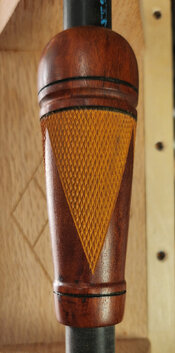

I wasn't patient enough to wait for the oil to initially cure on a test block, so grabbed an untreated piece of walnut out of my stock for a 2nd learning run. Still a lot to learn, but better. Critiques and advice welcomed!
I'm not one to critique, I've never tried it. Looks really good to me. Things that aren't perfect are visible to you as well as me, and since I have no idea how to make corrections (if warranted) I'll just say nicely done!

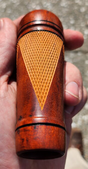

After a little more flat wood practice I moved to checkering on a round surface - definitely more of a challenge (as if it needed to be more challenging)! I had an old barrel I'd "rejected" for one reason or another - chakte viga or maybe kok, can't remember which - and got busy. This is the third panel on this block, the best yet. It's a slow learning curve, but I'm making progress.
