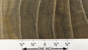

pistachio, chinese 1 end grain s100 plh.webp pistachio, chinese 1 end grain closeup s100 plh.webp
Atlas of Hardwood Identification:
