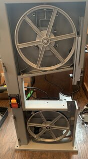

Hello everyone, very new here but am pretty blown away by the number of folks here and how spread out everyone is (even Texas). I have an issue and feel this is the place for help: I was gifted a 10" Craftsman bandsaw (119.214000). It had a shredded belt which I replaced. Put the lower bearing wheel back on - belt wouldn't track - kept slipping forward until it came off. Adjusted top wheel tracking, no dice.
Next, I about stripped the unit down, cleaned it, replaced the bearings and had to adjust the trunnion for the lower bearing wheel bolt to attempt to get parallel/coplanar. For a while it was either the motor pulley belt would keep slipping forward and come off or if that was set then the blade would constantly track off - very difficult to get both squared away at the same time. I have a feeling the issue lies with the trunnion bolts and lower bearing wheel in getting/keeping parallel and coplanar.
Since many bandsaws are somewhat built the same and involve a trunnion on the lower bolt, does anyone have any advice on ways to set this? I'm sure there's a way much easier than I have been trying.
I assume you mean blade and not belt. Take piece of plywood. 10" wide. Cut a notch so you can put up against top ane bottom wheels. Make it long enough to touch top and bottom of both wheels. That is how you match them up parrelel with each other. Start there. I assume tires are good
If you can't keep the band on after following the already mentioned suggestions, check the tension mechanism behind the upper wheel. If the belt has been over-tensioned it could have bent / broken something.
