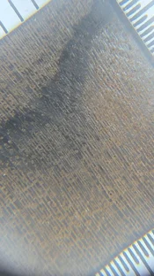

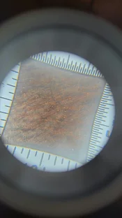

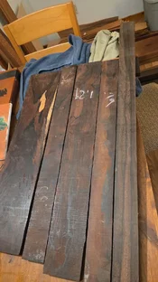

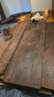

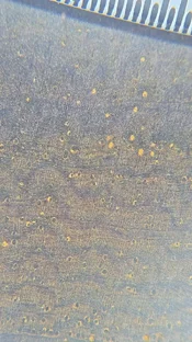

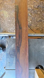

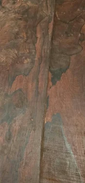

I was looking to buy some ziricote and the guy sent me the first 2 pictures. Immediately, i realized that only 1 of these boards is ziricote. The rest strongly appear to be dalbergia. We've had some back and forth trying to identify the exact species.
Density: 73pcf
UV fluorescence: streaked faint blue (wood)
The strong rays and feathering in the lighter long grain initially made me think D. Cochinchinensis, but @Jperry93 pointed out that the pores appear to be much too large to be D. Cochinchinensis. James suggested D. Spruceana, which i agree is also a good match. That said, I don't think i can even rule out D. Stevensonii or D. Retusa at this point. The end grain seems off for retusa, but these came in a lot that contained a lot of retusa and i understand that the landscape pattern is most common in retusa and nigra.
Any insight on these? Sorry the photos are not the greatest.

Many of the Madagascan dalbergias have this pattern too. Sadly IDing those is basically impossible apart from the really common ones like greveana, baronii, maritima, louvelii and a few others.
Definitely dalbergia.
