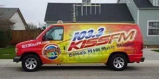

I suggest that you look for someone who does acrylic vehicle wrap. This would be considered a "small" job for them, but the product must go on the outer surface, (like the wrap advertisement on a truck or car). unlike decals that are made to go on the inner surface of glass.
like this???
like this???
Brilliant!!
