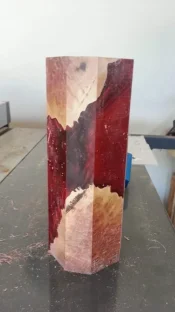

Dave, is that white part I see in between the burl cap pieces a reflection of the paint can, or is the resin translucent and I am seeing the white of the paint can through the resin? I actually wanted to ask earlier if you'd be able to see the pepper and the void, but this worked out even better!!
Thanks, Butch
Thanks, Butch
That must be a reflection Butch. This thing has a lot of dye and pearl ex in it. You can make translucent by usinga lot less of both.

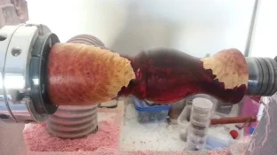

Hello again folks. Finally got some time to work on the peppermill, so I thought I'd show you were I was at with it. Hope you guys enjoy and thanks for following along.

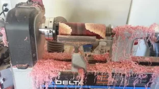

Cutting off the corners, so my tools don't beat me to death.

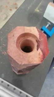

A little drilling out for the components

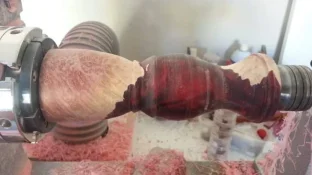

Sanding, sanding, and more sanding!! She's getting there slowly but surely. Hopefully I'll get the body all sanded out and the top finished tomorrow. Maybe soon we'll have ourselves a peppermill. Thanks for lookin.

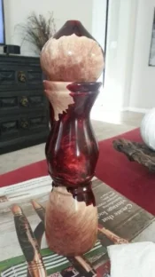

Ok. One more from today. Still have to fill some small pin holes (pretty common with resin) and another round of sanding and polishing, but here's a preview. Hope you guys like it!!!

I can't say what I would like to say................BUT holy cow, what a SWEET peppermill, and tutoiriol, thank you for sharing
