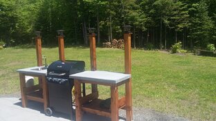

Figured I would post something that I recently completed. This isn’t “Fine Woodworking” by any means, but the result was something that I thought turned out pretty well. The overall construction is made from 4x4 and 2x4 cedar, with a lap joint construction to stand up to the weight. Between the concrete countertop and the two ceramic grills, this cart weights around 1,100 lbs, so the structure had to be strong.
After the frame was built, a facade of 1x4 cedar was added all the way around to help with the aesthetic. This was my first time building drawers, and was happy that they actually fit! The concrete top was an adventure, and involved making a custom melamine form with foam inserts in order to pour the concrete. Inside the concrete is a wire mesh, plus ½” rebar in the narrow parts for strength. The top is finished with 6-7 coats of tung oil for a waterproof finish.
I’ll add some additional replies with some of the build process.
Thanks for the inspiration, not as fancy as yours but the wife likes it. I poured my tops in place, haven't sealed them yet I'm waiting a few day for the concrete to fully cure. I opted to leave it open as I rains a lot here and any enclosed space would turn into a moldy home for field mice.
