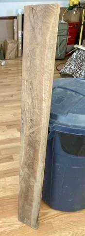

How bout a piece final size 6" x 3" x 1-1/8" . I'd need to cut from larger piece and trim to remove split area, might be able to send First Class...will know once cut and trimmed.Good morning Tim @TimR . Do you have any cutoffs from that board? Enough for a small bowl(s) 3x3? Jim

Am I 100% sure, nope. You may recall we had this discussion about 2 yrs ago from other lumber I had that seemed similar. My smeller not as good as I'd like, which can be a bad thing! Oh...and there was a big crack in this piece that I cut away.This doesn't look like the krugiodendron ferreum I am familiar with. I have had several log sections and several formal IWCS samples (only 6 x 3 x .5", but with ID down to where cut), and all have been a fairly uniform darker brown with no figure. The density has meant that all have had a crack somewhere, even at sample size. Are you sure this is krugiodendron and not just another wood w common name ironwood?
It does look like African Olivewood. However, the specific gravity of olivewood at 12% MC is listed as .99, which should barely float. Tim has shown pictures of this wood sunken and he’s told me it sinks like a rock. Whatever it is it has some unique grain patterns when turned. I may do some digging today on this.Am I 100% sure, nope. You may recall we had this discussion about 2 yrs ago from other lumber I had that seemed similar. My smeller not as good as I'd like, which can be a bad thing! Oh...and there was a big crack in this piece that I cut away.
So in full disclosure to @JR Parks , recognize this may be Black Ironwood or an African Olivewood...either way, it's heavier than water and extremely dense.
Would you happen to have a verified piece of krugiodendron ferreum for sale or trade? I just need a small piece (7/8" square x 5") for a pen. Thanks.This doesn't look like the krugiodendron ferreum I am familiar with. I have had several log sections and several formal IWCS samples (only 6 x 3 x .5", but with ID down to where cut), and all have been a fairly uniform darker brown with no figure. The density has meant that all have had a crack somewhere, even at sample size. Are you sure this is krugiodendron and not just another wood w common name ironwood?
