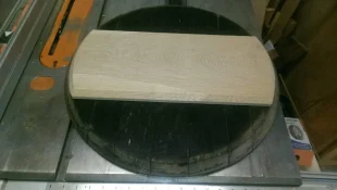

First I took a piece of oak, used a stick with two holes and a pencil and finishing nail to draw a 19 inch radius on the board ends, cut on bandsaw, sanded, routed a bevel on them and set on top of the backside of the lid.

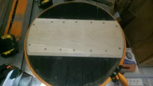

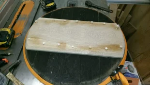

Then I wrap the lid with a strap clamp to pull it together as much as possible and drill holes for the screws. I forgot to take a photo but I also sand clean the area under the reinforcement and use some glue as I do this. Start in the middle with the screws and work out to either end.
I thought about taking the lid apart and jointing all the edges to give a really tight fit but heck, these are tables using beat up barrel heads and it'd screw up the outside edge and I'd have to do lots of work to get a good circle again. You'll have a few slight gaps here and there but again, These are beat up barrel lids :sarcastic:

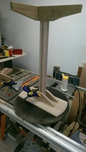

Then the leg assembly, Made some supports to give a solid attachment to the top. Drilled pilot holes, used screws and glue and then plugged the holes.
Cut off all the plugs, sanded everything down and added adjustable leveling feet, I can make stuff dead flat on my surface plate but when it gets to the end user it seems the floor is almost always not flat. Using those feet on stuff like this has eliminated house calls to fine tune stuff for their floors.

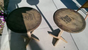

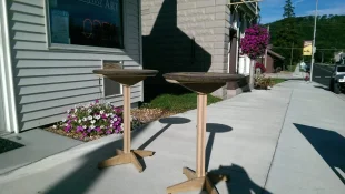

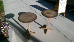

It's been a bit but I finally got them finished. Had a call last night from a potential customer but they decided not to as they were 2 inches too tall for the space they were thinking of (I honestly think they didn't like the price and wanted an excuse to bail but that's their problem. I know what I have into them and the quality of the build so I'll hold out for the right customer)
3 coats of satin Poly and then rubbed out. I didn't take it too far as I wanted the tops to really show they were used barrel heads with the associated dings and patina.
C and C are welcome.
Very nice Colin! I built a coat rack for the house out of Mesquite that is that exact design for the feet. Looks great, I'm sure they'll sell. Tony
Man those should sell like flapjacks. You get those in front of the right crowd and I don't think you can make them fast enough.
Look awesome in my book, but looking across the top of the table in the second picture I foresee a lot of spilled drinks in a bar environment. That might be a no-sale point for someone looking at replacing drinks and cleaning up the mess.
Nah - that's an attribute. Colin is a good enough salesman to make point but I don't see bars as his market anyway. He can sell them to individuals at a much higher price point than the pain and hassle of dickering with an establishment looking for a huge price break on 50 or 100 of them.
I see what you're saying but I actually took a glass of water and tested them out, it looks worse in the photo for some reason. I could have planed a few spots but then I'd have cut into the stamp and fargled the patina. If someone really wanted a glass flat surface I suppose I could chuck one up on the lathe, turn round and border it and then pour in that tabletop epoxy but of course they'd pay significantly more for them :sarcastic:

Colin, looks good, the only thing that looks off to me is the mounting plate to the lid (table top). Your first picture makes it look as if it sticks out a bit. If it is too complicated to adjust the round-over angle, could you shorten the mounting plate by one inch or so and have the edges stepped in the split difference? I would step it in so that the lid with mounting plate attached could theoretically fit within the original barrel. A symmetry thing I guess. But if you enjoy them, who cares?
