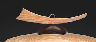

Pinky, that's a masterpiece! As far as the "clamshell" on the top, I like it - somehow it reminds me of the Chrysler Building in NYC. I'd probably opt to leave it. If too much smaller, I don't think it would work, and definitely not much bigger. Much more distinctive that a simple knob of finial.
Maybe think about what I would call Japanese inspired top - something like below - If you are unsure of the clamshell.
Or some form of a temple arch

My first thought was the same as Mike's. I do like the clamshell, but may give others the thought of a famous NYC building.
As with others, my thoughts are to go with a horizontal finial as a counter to the vertical lines.
One idea is two horizontal pieces of different widths to bring the different widths of the corner splines detail out. Could then have a single or double vertical. I like the idea of using the curved horizontal in Mike's last picture. Here is a bad sketch to illustrate my description.
I like John's idea to keep it relatively narrow and low to the top so it wouldn't give the impression of a handle.
