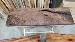

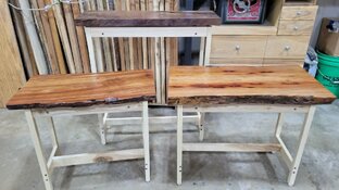

I started working on these a few months ago and worked on them here and there, as time allowed. We needed a few plant stands for around the house, each able to accommodate holding a few plants in front of various windows in our home - hence the heights.

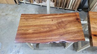

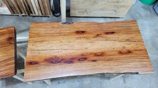

Ash for the bases, screwed together for the sake of time, with walnut plugs. Tops are Narra x2 (that came from @Tony quite some time ago) and Walnut. Minwax Polycrylic for the finish. While I've always preferred the look and feel of a good oil based finish, it's really hard to beat the ease and quick cure time of the water based Polycrylic - and fumes that don't stink up the shop (or waft into the house) for far too long...

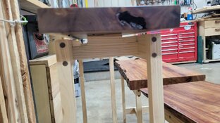

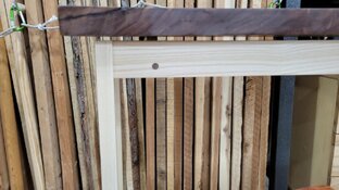

I came across a floating top design for a table quite some time ago - at least 10 years ago - that I always wanted to build. Decided that I would incorporate it into this build. The tops float about 1/4" off the base, with the end stretchers set in, with cutouts to really help it look like it's floating.
Wife's happy with them - and so am I!

Beautiful stands! One thing about plant stands is they get lots of sun and usually water exposure. I got one made from a juniper live edge from a place up the road a few years ago. It really needs a refinish job on top.
Yeah, I gave the tops a couple extra coats of finish for that reason. But do imagine that at some point I'll have to refinish them. My wife is pretty good though about having trays or plates under her plants to help contain water, which will help too.
