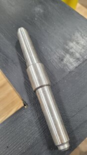

Ryan, I've got a MT2 tail stock alignment tool that I plan to eventually list for sale and can easily part with now. I can check later what brand it is and message you about it. Should be able to slip it in the box of wood that'll be headed your way, so there'd be no extra shipping cost.
That would be great. Thanks!
