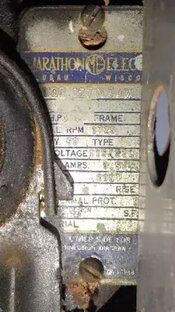

Matt did a quick search for parts, just in case and yeah ebay has a good list of pieces and parts, Only issue now is the motor, the gentlemen did not know how bit it was and the plate says .5 amps. I am still going to go see it and run it to see what it sounds like etc. I guess I can always find a bigger motor, In fact I just moved an old craftsman alum bed lathe (I won at an auction a few years back in Kansas) it came with {If I Remember correctly} a 1 1/2 horse induction motor. Just plugged in it NC when I was there to see if the motor turned and it did. Might be a good donor motor. But who knows really have to just get in and see what can be done.

Sure do not see how it could be .5 amp motor. That is puny. Lathe came from bigger is better days. I have an old century 1/2 horse. It is huge and horses were bigger then...

Only half an amp? At 220V, that's 110W -- and 746W is 1 hp ... no, that can't be right, it's less than 1/6 hp -- and half that if it's running 110V.
Even 5A would be on the small side for a lathe motor (for reference, the HarborFreight 12" x 33" lathe with Reeves drive has a 110V - 6A motor, and I'd stall that out taking a medium-light cut.)

Ok got that wrong, here is the data plate, its 3/4 horse I believe. not sure what the .5 amps is. I am by no means an electrician. one of those things I have to phone a friend . Image.jpg
