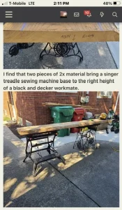

I find that two pieces of 2x material bring a singer treadle sewing machine base to the right height of a black and decker workmate.
As luck would have it, I kept my treadle base and workmate just knowing a use would come with them!
Greg, I tried editing the post but may have just confused things. Just wanted to share that I have the sewing machine base and Workmate too! 😄
That's cool brother, I dig the b&d workmates. And now I found another use for the singer sewing machine base, I've got a few of them.
