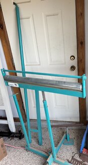

If you want a very large one to get in long sleeve ones. I have this one for sale … probably too heavy to ship … came from a company in Canada
IMG_2683.jpeg IMG_2682.jpeg About a 5 ft bar

Hi @woodman6415 that’s quite an impressive setup! It’s too big for what I’m looking for, but maybe someone WB might be interested. Thanks for posting the photos!
