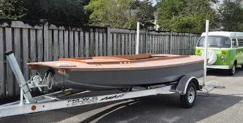

Coaming installed, filetted and shaped - have a little final fairing to do this evening, then hope to get a final epoxy coat on tomorrow (2 more coats for coaming and a few high exposure areas), then can get some paint on the deck and start getting things hooked up and fastened.

Just sitting on the trailer your boat's looking really nice Henry. I'm anxious to hear how it performs on the water. I'm wondering if it would benefit from a pair of small chines along the sides close to the bow to help deflect spray from the stubbed off bow? On the water tests are probably the only way to tell.
I bet it won't take much HP to lift it out of the water.
I'm anxious to see how "wet" the ride is, too. I don't expect totally dry for this size boat, but I think it should do ok.
Good point. If the bow lifts high enough, you should stay pretty dry in the back because of the chines near the edge of the hull.
Getting closer. Hydroturf down, first top coat on, and cleats and deck electrical outlets wired and installed. Final top coat on decks and hull sides and some details to finish, but just about ready for a water test with the trolling motor then to the shop for power. Finally seeing the light at the end of the tunnel!
