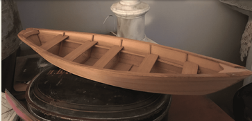

Modeling is tougher than I thought. First, tools aren't really scaled to work with 1mm plywood. Second, I really have to shift my normally perfectionist mindset to a good enough mindset - it's only a freakin' model! Anyway, the basic shape is done. A good learning experience in terms of understanding the basics of lofting, stitching and build process - and now I can better visualize size and scale and think through how I'll use it what finishing touches I'll wait for the real build.
Looks pretty good to me, I admire your patience. I could never get into model building, I've never enjoyed working on small builds. I've been watching every boat building video that I come across, one thing that I've noticed is that many of the pros use exterior fir plywood. I think that I am going to modify the layout of my mini Mac to make it a work better for 2 people. I'm going to incorporate some movable seating to make it easier to distribute the weight depending on the number of passengers. The design calls it a solo boat that will handle 2 adults on flat water, it also suggests adding a couple of inches to the height of the sides.
all those little pieces make my hands hurt just thinking about them. Modeling tools like a mini TS make a lot of the work easier. Looks good to me..

No doubt fir is fine if well-encapsulated, should work just as well as the imported stuff, depending on your specific needs. Weight will be important in this build - gaining or losing an inch of draft in the shallows and improving odds of being able to move the boat off a sand bar are keys for me. Okoume yields significant weight reduction, 20-25%, relative to Fir (or Meranti). It is also a bit less stiff and brittle, which will aid in building the curves as well as some general resilience. For those benefits, I'm paying a bit more and giving up a touch of natural rot resistance, but with a good epoxy job and ability to keep the boat covered (and often in my shop) when not in use, I shouldn't lose any longevity.

Looks good. I'd think about making a little sharper bow with chines to better cut through chop and carry the spray away better. makes for a drier ride.
Tain't bad my NC friend. I bet it would outrun my first boat model build!
That picture makes it look at bit wider at the nose tha it really is...
