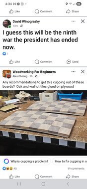

The thinner the wood is the more chance for movement if wet on one side. I found this out the hard way. Made 2 pieces of thick veneer- booked. Glued onto to piece of 1/2 ply about 20x30. It was perfect. 2 days later it had bowed way beyond repair.....
I sand all inside pieces before glue up.
Wow, bowed 1/2" plywood, that's kind of hard to do. Maybe gluing the veneer on one side of the ply caused enough force to bow the piece? Or did you glue veneer on both sides at the same time?
1 side- this was the problem- you have to do both sides. lay one of my maple thins on bench- spray one side with water- moves a bunch
