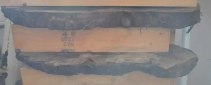

Cliff has a new thread on his freezer method and that information should go to his thread. My purpose of starting this thread is to promote the discussion on what others are doing that has been successful to dry wood and keep it from warping, cracking, twisting and control movement in general. And to that end show what I'm currently doing. I'm just using information picked up off the net that I read and tweaking it to suit my circumstances. I put a gallon of Dawn dishwashing liquid into a drum with a 1/4 tab of swimming pool chlorine ( to prevent mold ). The thing I do different is the time I let it set in the drum. Rather than several days I use several months. The burl is so water logged that it don't float when I take it out. One advantage to me is that really I can deal with it when I find the time and not have to worry about it. I rinsed the burl then let it soak in clean water in a drum for several more weeks. I let it air dry for a couple of weeks then cut it and let it air dry in the shop on my planner table. Turning it over every few days and most of it is straight. Really only two pieces that are not. I plan on boiling those two pieces and seeing if that makes a difference. I'll try to put more information with the photos. One thing you won't see is a toe shot. Hobbits are very sensitive about that. But should it ever happen and you are the first to point it out to me. Then I would have to give up some very ugly wood.
Latest batch I took out today. Will let it dry some before I cut it
Walnut slabs air drying.
