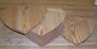

Next I cut the remaining blank down the middle, and jointed the faces so the sides will fit back together nicely:
[attachment=28847]

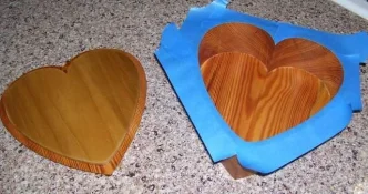

I missed a few pictures here but to explain: I glued to bottom back on (be mindful of the orientation so the grain lines up) and sanded the outside smooth, I shaped the top a bit and glued a piece of poplar to the underside that will drop in the top and keep the lid in position. Here it is with finish applied and taped off flocking.
[attachment=28853]
