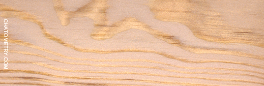

We did not see a significant impact of cut, with the following notes:
1) Softwoods are more chatoyant in their late growth rings (see example below). If your measurement area is on a QS surface you average correctly a number of early and late growth rings. But on FS surfaces you may end up with a measurement area that is mostly on late growth ring, thus reading a higher value, and vice versa.
2) Some cells (I ask wood anatomy experts to correct me if I am wrong) like medullary rays or flecks may have a different chatoyance; so this might make cut type relevant.
3) Figure may highlight chatoyance, and figure depends on cut.

No idea. We did some qualitative tests here:
We will do more.
