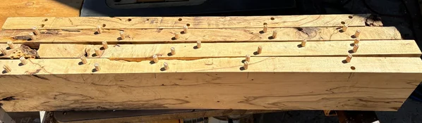

Today I got all my edges straight and square, so I got it ready for dowels. Since it's over 1 1/2" thick right now, instead of putting in just one row of dowels, I set it up for two rows. The dowels in the edges are dowels that are used to align the pieces, then are removed and the regulars are glued in, with the edges left dry on the dowel side. IMG_7210.webp
These are the dowels. They are cut halfway on one end, rotate 90 degrees and cut halfway. They become loose in the dowel hole and are easy to remove. IMG_7213.webp

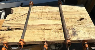

I got it glued up. Will keep it in the clamps till tomorrow morning, giving it plenty of time to cure. This is the bottom side seen. It's worse than the top, but there is one area on the left side that is rotten, and needs a filler piece of wood. I wish I hadn't cut up all the scraps as there would have been about 3 pieces that would have filled in enough to not look like a flaw.
There is a lot of punk, voids and other things I'm going to fill in order to get a flat solid surface. Right now, it closer to 38" long at the left side, but where the crotch area is, it's about 35?. I'm going to be allowed by the customer to cut it short if necessary, otherwise I'll have to do a fill. That might not be too bad, or if her husband has a say, leave it like it is because, "It's wood, and wood has all kinds of flaws'.

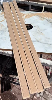

Picture #4 shows the boxes assembled and loaded with the Palo Verde to be cast. IMG_7325.webp

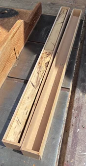

Picture #3 shows the bottom and ends assembled. Sides are next, but didn't get a picture of an empty box. IMG_7322.webp

Picture #4 shows the boxes assembled and loaded with the Palo Verde to be cast. View attachment 292068
Picture #3 shows the bottom and ends assembled. Sides are next, but didn't get a picture of an empty box. View attachment 292067
