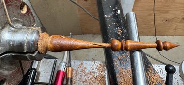

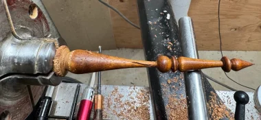

Tried some practice finial work with a piece of Koa. Was finishing as I went along. Had the taper down to 1/16 thick. Did great till I tried abrasive paste. Squeezed a bit to hard and it broke right off..
Might try fixing it.
Sawdust and epoxy?
It's broken completely off. I balanced it back for the photo.
Was thinking drill a small hole in the ball and reglue tapered part in. Then turn taper and finish base.
Worse comes to worse it goes in the burn barrel. Was fun practice anyway!
That's what I'd do. Cut the broken section off at the ball and drill a small hole 1/4" into the ball (whatever diameter drill fits best). Either cut if off or just turn the tapered end leaving a round mortise the same diameter as the hole you drilled into the ball. Then just glue them together, no one will be the wiser.
It was looking good - your fix idea might work. One option would be to drill a hole in the ball and glue in a piece of toothpick. Then start the lower piece with something like a saucer (it would balance the one on the "good side" of the ball) which would give you enough mass to drill another hole and glue the toothpick in. A miniature loose tenon, if you get my drift.
My experience attempting thin finials taught me the most important thing is that the wood must have straight grain aligned perfectly along the axis - the slightest angle creates a weak area of short grain.
