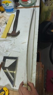

Mark curve by steel rule and clamps
Just mark
The rise
Just mark
The rise
