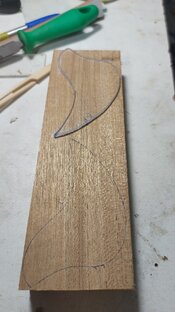

First cuts...yet rough
Freijó wood
Freijó= Cordia goeldiana Huber

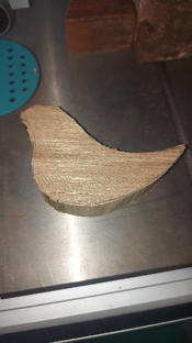

We can find branches here any place...will be any wood ...fruit wood or what I find...only the birds nice wood to capture the eyes.
About cut my bandsaw now has the 1/2" blade and the minimum radius is 2 1/2".Because I don't want to change for while for 1/4" ( smallest minimum e radius) .I was afraid to reach the line and something be wrong.I made some relief cuts and after when I tried to follow the line again the small wedges go inside and blocked betwen blade and bearings and that PVC pipe.So I stopped that way to make a problem bigger than I need.
At 57 yo I love to read any comment positive or constructive critic because I'll be learning forever and I just start working using bandsaw...a long learning curve to come.The mistake today will be the experience tomorrow.
Thank you for comment.

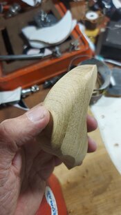

Still shaping the birds...more dificult than I was thinking.
Birds are traditionally carved in Slavic cultures. They use a stock knife. (Another reason to get one?) I believe that there’s a video on YouTube from swaytobor (strongway tools) where they make a small bird from alder with their stock knife. There is a definite marketing element but it is cool to see it used.
  • #29
One more step...
My birds will be a bad copy for that I showed at begining.
Just an "allusion" and not a real copy.That ones are very well done.
I used a router bit to shape some curves...the others will be by hand...files...sandpaper....etc.
Curves by router bit
Some places the bit can't cut
I need to shape by sandpaper
Nice curve as guide
I used a 1/4" rod and a blue "handle" to protect my fingers
Worked pretty well

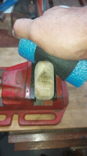

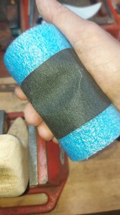

I am still sanding my birds.Today I used a new "ttool".
in Brazil we call this espaguete de piscina ("pool spaghetti" )
Easy to shape and comfortable at hands.
File as a guide
Heat the file
Done
Mold
Easy to gtip and comfortable
Big radius

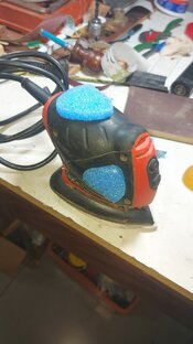

  • #31
Other use of this spaghetti
My sander lost the gel cushion (too old)
I used some pieces as a cushion.
This old model
Gel is garbage
Just rough cut
Doulbe tape
Works good

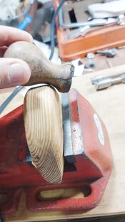

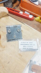

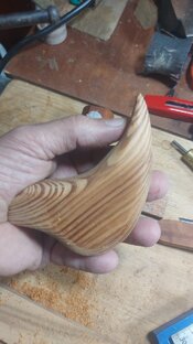

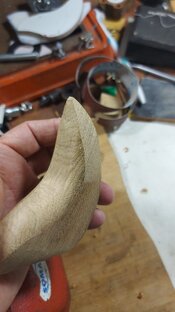

Today I spent some more time with my birds.

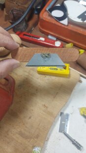

I told before about using a utility knife blade as a scraper.
It worked very well at birds.Soft wood is not scraper friendly but helped a lot .
Lee Valley mini scrapes
This blade works very well as a mini scraper
Just screwed at a wood handle
Pass through holes to avoid split
You need to help keep blade not bending...it is not for this cut they created this blade
Nice shaves at soft wood

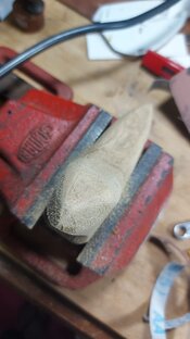

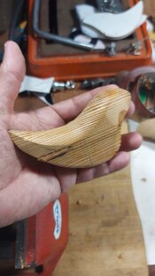

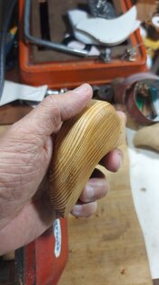

Look this part at picture above
Nice wood
The below sanded more time than above

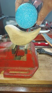

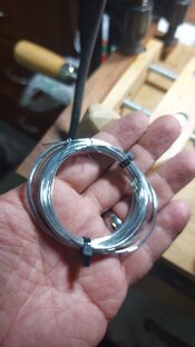

  • #34
In my opinion many woodworkers are not fan of hand sanding (sometimes I don't like using machines too).
My birds are manual sanding (time consuming)... can be a relaxing time shaping that curves.
Today I use this idea and it worked very well.
I want to make some other birds after these three using another woods.

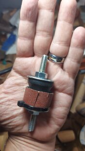

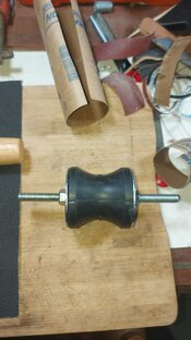

How do you call this? (A rubber to avoid vibration at pump or compressors bases)
First idea
This is better because plastic marked the bird body
Wire
Marked at first idea
Second one works nicely and fast
Scraped the marks

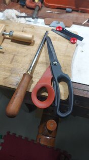

  • #35

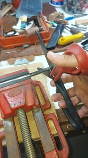

I have one bigger for test tomorrow...
During the sandpaper cut by scissors the blade became dull.
The better and fast way to recovery when the damage is very soft is just try to cut a burnisher rod.
Tip from Ron Hock the ex-owner of Hock Blades (now a Lee Valley company).
I need a bigger sandpaper
Just for show the idea
Scissors and burnisher
Try to cut...the blade will be fantastic again
First idea
Wire
Scraped the marks
Rubber isolator mounts. Or rubber bushing depending on installation.

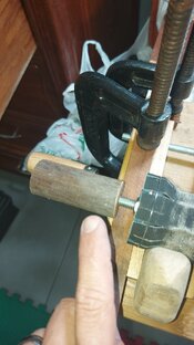

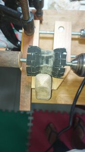

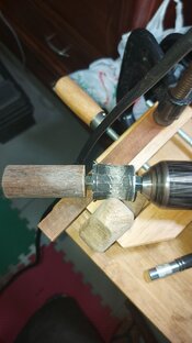

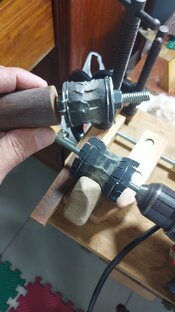

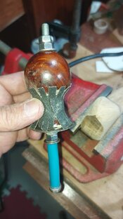

  • #37
I did the second drum sander this morning.
Works very good
The loose handle permit use in both
Sanding is very good and time saving

I just cuted two pieces of wood for two new birds...I am improving my learning curve and the next will be easy and fast to do.
One wood is Jatobá (Hymenaea courbaril) and the other is Vinhático (Plathymenia reticulata)
Jatobá on right
End grain
Vinhático
