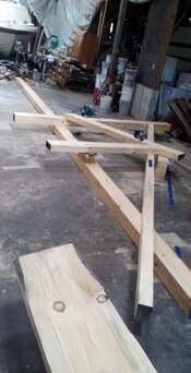

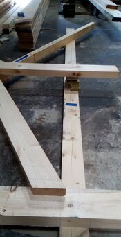

I am looking at having to retract my try at this for now. I have the components but not yet the time. I am working longer hours at work and trying to get a timber frame cut for work. I have had to source all the tools and draw all the joints as well as laying the truss out. Both on paper and lining it out on the concrete floor. Then making a direct transcribe to the wooden components. I have 2 helpers. 1 is 19 and energetic yet not trained, the other is older than I and doesn't care to learn the skill set. IMG_20230928_200923_01.jpg IMG_20230928_200929_01.jpg

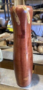

About a week ago I received a couple of pieces of spalted Maple Burl Peppermill blanks from @Mike1950. Made a PM -10”. Turned then dyed black. Sanded back the black. Then dyed red over the black and sanded it back again. Several coats of satin poly for finish. Including a pic of the second blank I have. Thanks
