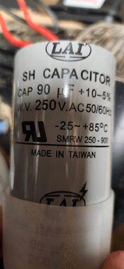

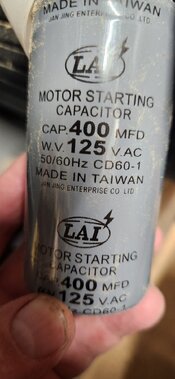

Ok, so I'm needing help. I have a Laguna 1412 bandsaw that I've had for a couple years. Never had any problems until lately. When I go to start it up, it starts slowly then throws the breaker. I changed out to a new breaker and still doing it. It has always started fine. I took the pulley off to check to see if the bearing was bad but it seems fine. Started the saw up with just the motor and it ran. Any suggestions?
@woodtickgreg
@woodtickgreg
what the people above said. Start capacitor. Also there's a switch Inside, I forget what it's called, but it's used on startup. It's a centrifugal mechanism.
