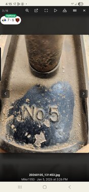

Is this a 5 1/2 by any chance? Regardless, If it goes up for sale I would like to put my hat in the ring for it…

I have a solid bottom 5. Also. I am catching up. I will.picture.

My over-achieving attempt to highlight the one I’m interested in didn’t post for some reason, so here’s another crack at it. It’s from your 2nd posted picture of Stanleys on a Shelf.
