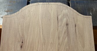

Got it marked, and now need to make the correct mark because of the recess thew panel into.
That's how much I have at the top. The arched line will get another mark 5/16 above it. I'm not going to use space balls on the arch unless I have some additional time. There are enough to make the panel a solid fit.
Marked and ready for the bandsaw.
Cut it and will mark and cut the other 19 panels tomorrow, then sand and have them ready to router the raised edges Sunday.
