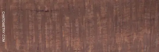

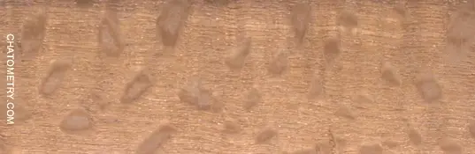

Very simple design as usual, but I really like how the endgrain showed up at the end. I used Louro Faia and Wenge.
In addition, Louro Faia (panopsis spp.) is way more chatoyant than leopardwood (roupala spp.), even if this can't be seen from the pictures.
