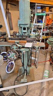

I got the long stretchers in today and a couple coats of polly on. For the long stretchers I used a 1" deep mortis and tendon with draw bolts, I've built a couple of beds this way and it makes a good tight joint. Tomorrow I'm hoping to remove the casters from my old bench and install them on the new one. I may have to leave this project for a while, we are supposed to get a break in this heat wave and I have some neglected outdoor projects.

2x3 laminated white oak glued up face to face. After pictures were taken I added 3/4” bench dog holes and a 6” wood vise. I use the bench vise and dogs a lot more than I thought and the whole unit is quite heavy For stability.

  • #65
That's a beast, what did you use for a finish on the top. I used some spar polyurethane on my frame, mostly because I had a part can. I was thinking a oil finish would be better for the top. It's going to be rock maple so whatever I use will not penitraet much.

That's a beast, what did you use for a finish on the top. I used some spar polyurethane on my frame, mostly because I had a part can. I was thinking an oil finish would be better for the top. It's going to be rock maple so whatever I use will not penitraet much.
Min Wax Satin Polyurethane. I’ve built a couple other benches and wood glue from glue ups pops right off. The picture I took is with finish wet yet. Did you hand chop your mortises or use a machine? Yours is looking pretty nice I must say👍

  • #73
The legs are laminated from boards so I left voids where I could. The others I drilled out the made a template so I could clean them up with my router and guide bushing. I'm hesitant to polyurethane the top but it would look nice.
